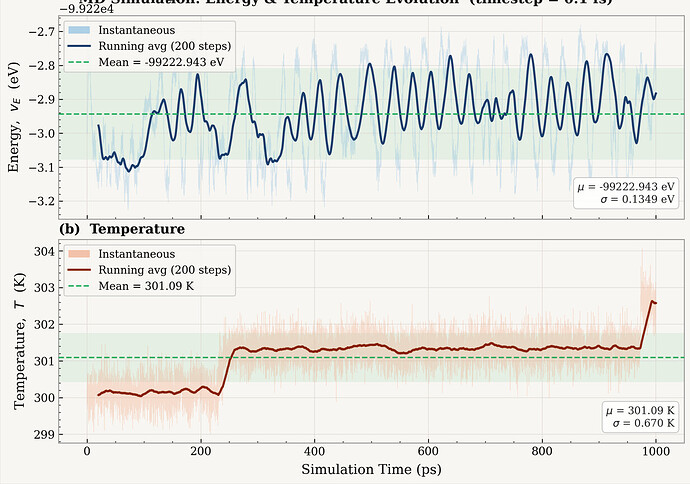

I am trying to simulate a Silicene-hBN bilayer heterostructure with a Stone-Wales defect. After running a fix nvt, during fix nve, I found that the system temperature suddenly jumped to a higher value. I have tried running the NVT for a longer period (5 ns), considering that the defect will be equilibrated by then, but the problem persists.

As you are running nve, I think the most likely reason would be abrupt shift of atom coordinates in a short time (probably a diffuse event of a defect?). Maybe you can try decreasing timestep or using a smooth variation of LJ, but sometimes the problem lies in the functional form of the force field, and cannot be easily solved.
Dumping out the trajectory may be helpful in understanding what is happening.
Since you are already using a timestep of 0.1fs, which is unusually small for the kinds of atoms you have (I would expect that you should be able to safely use 1fs, possibly even larger), I support the suspicion of @initialize that there could be something wrong with your choice of force field.
