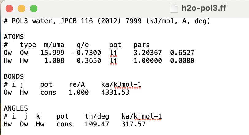

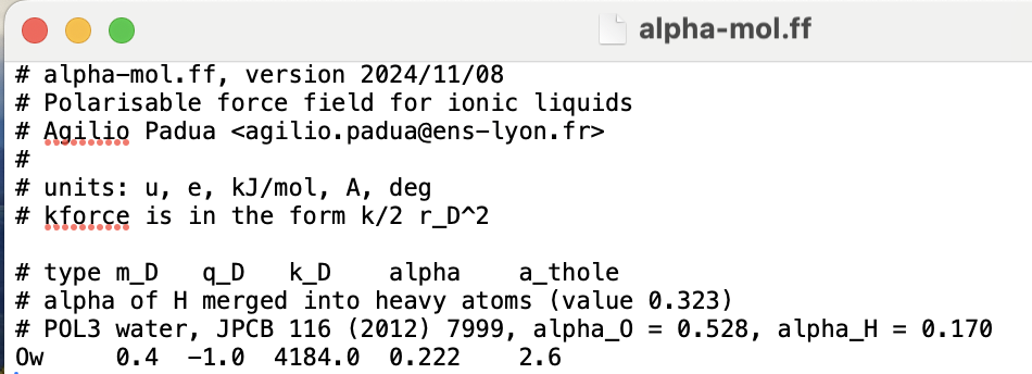

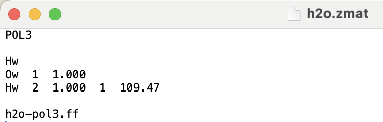

To clarify what I meant by “CL&Pol-style workflow”: I am attaching the fragment-style definition we use for POL3 water in our simulations. It consists of:
  • a modular .ff file defining atom types and LJ parameters,
  • a .zmat file defining molecular geometry,
  • an alpha-mol.ff entry defining the Drude parameters.
This allows us to build mixed systems (electrolytes + water) using fragment assembly tools and then apply controlled LJ cross-interaction scaling between fragments.
