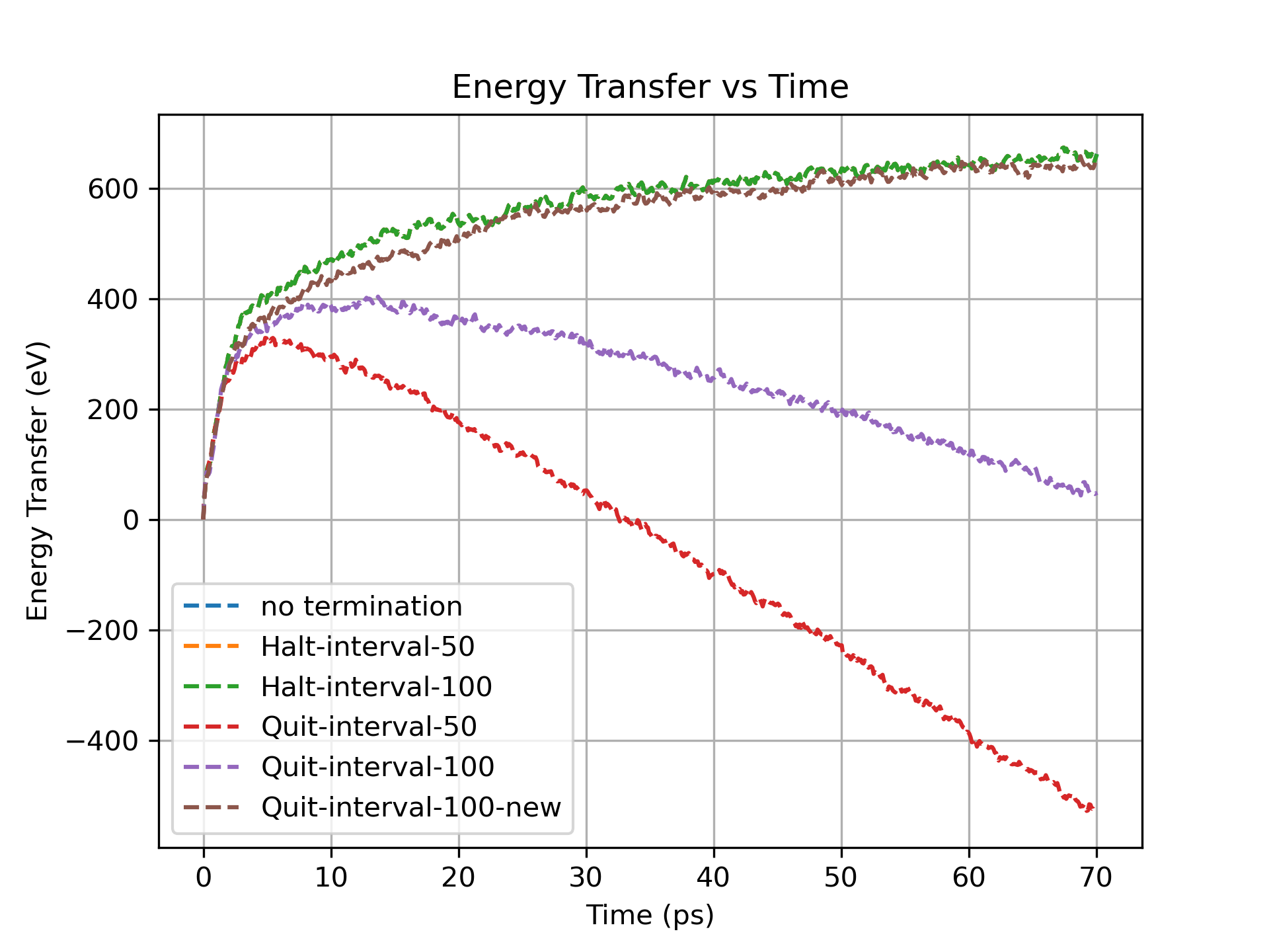

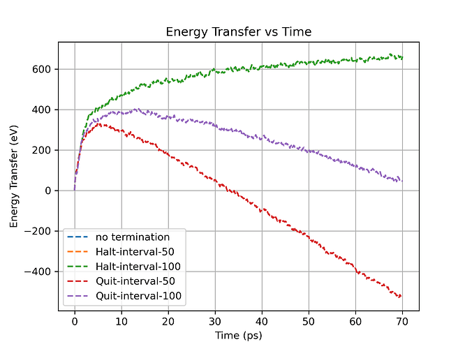

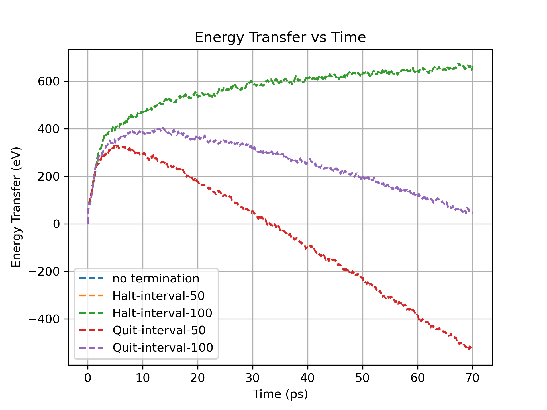

I added a plot. In this plot, ‘Quit‘ represent the first method, ‘Halt‘ represent the second method with ‘fix halt‘, the numbers represent the checking frequency (50 and 100 timesteps), and ‘no termination‘ represents running simulations without termination condition.
According to the plot, the second method and the method without termination conditions produce the same results. The first method produce different results; and within this method, different checking frequencies give different results.

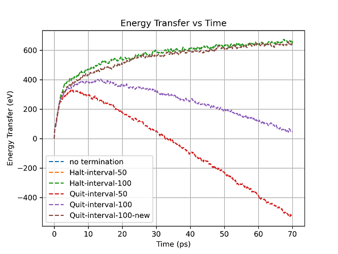

Thanks so much. It works. Previously I ignored the pre keyword, which by default reset the initial setup for each shorter runs. In the attached plot, the ‘Quit-interval-100-mew‘ represents the method that you suggested, this time it looks correct.
(Since I use different number of nodes on HPC, so the new method did not produce a line overlapped with lines generated by ‘fix halt‘ method. )
