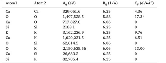

I’m trying to Simulate the reaction between K₂O and SiO₂ at 550°C.Compile the Born-Mayer-Huggins (BMH) potential function based on the article https://www.sciencedirect.com/science/article/pii/S0022309324000243?via%3Dihub, but encounter issues with atom loss and excessive pressure. Seeking assistance.

pair_style buck/coul/long 10.0
pair_coeff 1 1 2163.10000 6.25 0.0 # Si-Si
pair_coeff 2 1 62814.5000 6.06 0.0 # O-Si
pair_coeff 2 2 1497528.50 5.88 17.34 # O-O
pair_coeff 2 3 2150635.56 6.06 13.0 # O-K
pair_coeff 3 3 3162236.90 6.25 9.76 # K-K
pair_coeff 1 3 82705.4000 6.25 0.0 # Si-K

As your log shows, the energy minimisation ran for 100 steps, which is also the the maximum number of steps that you set – and therefore there’s every chance that you haven’t successfully resolved atom clashes with high potential energy resulting in an immediate box explosion.
That kind of behavior usually indicates that your initial geometry is bad and that you have overlapping atoms. The BMH style potentials are notorious for not having a steep repulsion when atoms come too close and then lead to a “Coulomb Catastrophe” since the charges become the dominant force and anions will be pulled on top of cations and vice versa and from there on there is no salvaging the simulation. Thus you have to be extremely careful with your geometry and running a minimization cannot “fix” things like it is possible with Lennard-Jones or Morse potentials when using them in combination with Coulomb interactions.
