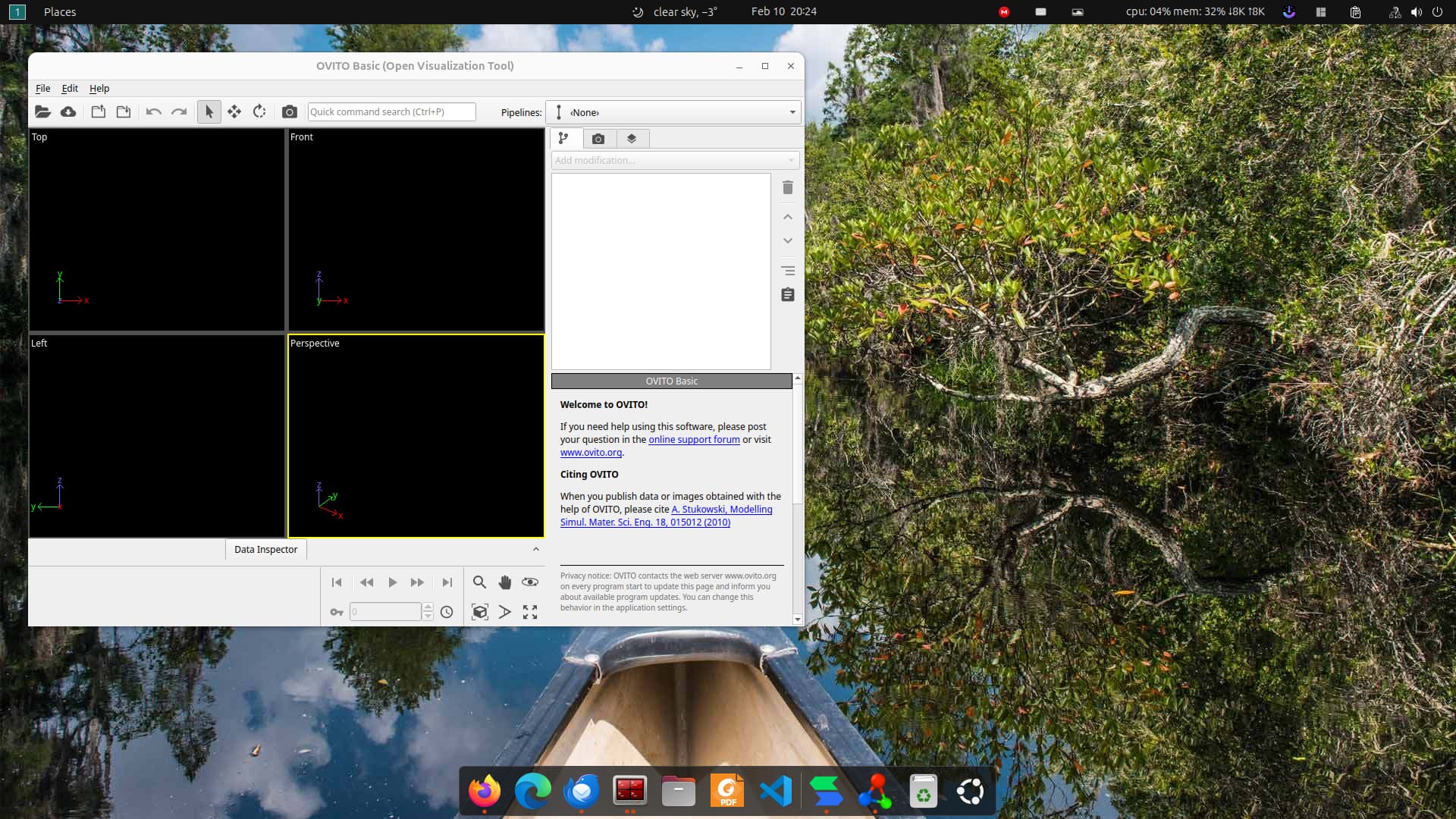

However, I’ve encountered an issue where the main window is not maximized by default when OVITO is opened. In the previous versions I used on Ubuntu 18.04 (including OVITO 2.9.0 and 3.1.2), I think the main window was maximized by default. I’ve looked through the options but wasn’t able to find a setting to adjust the window size or the initial state.

I just ran some quick tests on Manjaro (a different Linux distribution), and there, storing the window’s maximized state is working as expected. When you close the window while it’s maximized, this key:
mainwindow\maximized=true
is set in .config/Ovito/Ovito.conf. The next time I open OVITO, the maximized window state is restored.
I’m currently installing Ubuntu 24 to run some tests there.
I just ran a quick test on Ubuntu 24 LTS, and after starting OVITO for the first time, a configuration file is created in ~/.config/Ovito/Ovito.conf.
Inside this file, the mainwindow\maximized=true key-value pair is present, correctly storing the maximized state.
