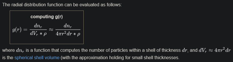

The value of the Radial Distribution Function (RDF) at a given r does not directly correspond to the number of neighbors at that distance. According to the RDF definition:
(CC-BY-SA Source)
You would need to reverse the normalization by dV_r \times \rho to convert from the RDF to the actual coordination number. Since dV_r does not increase linearly with r, you observe the decrease in g(r).

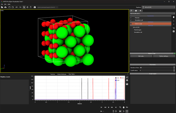

If you’re interested in calculating the actual number of particles in given distance, you can use the following Python modifier:
import numpy as np
from ovito.data import CutoffNeighborFinder, DataCollection
from ovito.pipeline import ModifierInterface
from traits.api import Float, Int
class NeighborCountModifier(ModifierInterface):
    num_bins = Int(400, label="Number of bins")
    r_max = Float(3.5, label="Cutoff radius")
    def modify(self, data: DataCollection, *, frame: int, **kwargs):
        bins = np.linspace(0, self.r_max, self.num_bins)
        ptypes = data.particles.particle_types
        finder = CutoffNeighborFinder(self.r_max, data)
        result = {}
        for index in range(data.particles.count):
            ptype_i = ptypes[index]
            for neigh in finder.find(index):
                if neigh.index < index:
                    continue
                ptype_j = ptypes[neigh.index]
                if ptype_i < ptype_j:
                    key = (ptype_i, ptype_j)
                else:
                    key = (ptype_j, ptype_i)
                if key not in result:
                    result[key] = np.zeros(len(bins))
                result[key][np.digitize(neigh.distance, bins)] += 1
        result_array = np.zeros((len(result), self.num_bins))
        tags = []
        for i, (k, v) in enumerate(result.items()):
            result_array[i] = v
            tags.append(
                f"{data.particles.particle_types.type_by_id(k[0]).name}-{data.particles.particle_types.type_by_id(k[1]).name}"
        table = data.tables.create(
            identifier="neighbor_counts", title="Neighbor_Counts"
        table.x = table.create_property("distance", data=bins)
        table.y = table.create_property("count", data=result_array.T, components=tags)
