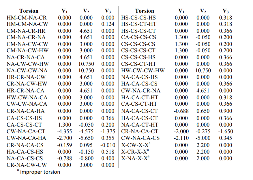

I want to simulate an ionic liquid using OPLS -AA force field. I made a data file which contains bond angle and dihedral information (not coefficients). I took torsional fourier coefficients V1 V2 V3 from a publication supporting doc but getting this error
ERROR: Incorrect args for dihedral coefficients (src/MOLECULE/dihedral_harmonic.cpp:251)
Last command: dihedral_coeff 1 -12.92 0 0 # C1-C2-N2-C3
I tried using dihedral_style ,harmonic ,opls ,fourier how can I fix this ?

I tried to figure it out but OPLS style has 4 arguments and I have only V1 V2 V3 values
Well, may be this means that the 4 parameters should be chosen as 0? I am not sure of that though, I am no expert of OPLS force field.
this is how they are given
I suppose you need to first know what is the form of the dihedral potential involved in your force field. Once you do it, you check the available ones within LAMMPS to find the one that duly matches. Then you learn the order in which you should input the coefficients (based on how many there are in the first place).
What do you mean by form of dihedral potential ?
You have to look at the mathematical expression of the potential, and compare to the expressions given in the documentation of LAMMPS.

Hi, OPLS-AA originally has 3 coefficients, and Fourier Function may include 4. Since OPLS-AA does not have the the fourth coefficient, then it should be zero in your input file where you define your forcefield.
