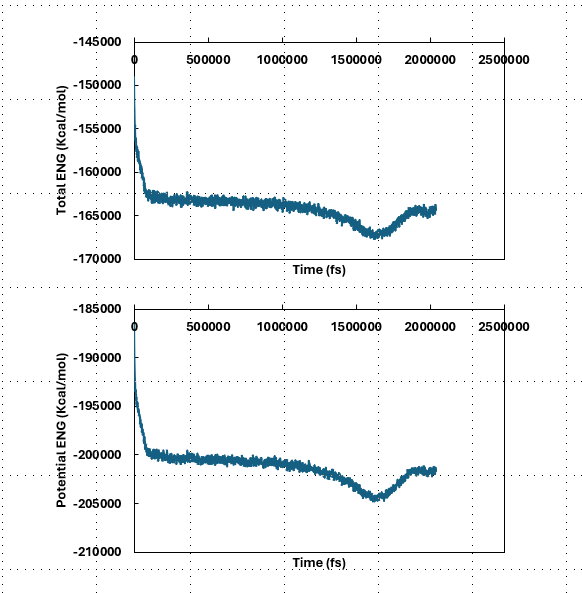

Hello LAMMPS users,
I have a system composed of 20 polymer molecules and 2200 water molecules (21060 atoms in total). I am using NPT at 600 K to equilibrate my system for 3000 ps. Starting after a few pico seconds, the total energy of system shows a plateaued phase, which continues until 1000 ps. But after this time, the equilibration is disrupted and the energy starts to become unstable. At this stage, the system also starts to expand again (density goes from 1.6 to 0.2 g/cm^3). I have checked the kinetic and potential energy of the system and the same trend can be seen for the potential energy, while kinetic profile stays stable. I have tried several approaches, such as increasing the temperature of only polymer molecules to 600 K and keeping the temperature of water molecules at 300 K. However, this does not work, either. I was wondering if anyone can help me to figure out the reason behind such behavior in my system.
I should mention that for my other systems with the same polymer molecules, but less number of water molecules, this has not happened and system seems to be working fine. I should also mention that the system has no charge, as well.
Thanks

Your simulation runs for 2.5 ns, contains water, and is run at 600 K. It does not surprise me that you observe a metastable state that suddenly turns to vapour. What would you expect to happen instead?
Dear @hothello, thank you for your response. I attached the input file here. Actually, I tried to impose temperature only on the polymer to eliminate the impact of high temperature on water expansion/evaporation. However, again the system was expanded and the energy was fluctuating after a while.
In fact, I tried imposing 600 K temperature both on all system and only on polymer particles.

If you don’t want the system to expand, then why do you keep running with fix npt?
Why not just stop the npt run way before the expansion starts and continue with fix nvt?
