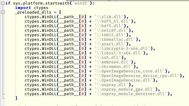

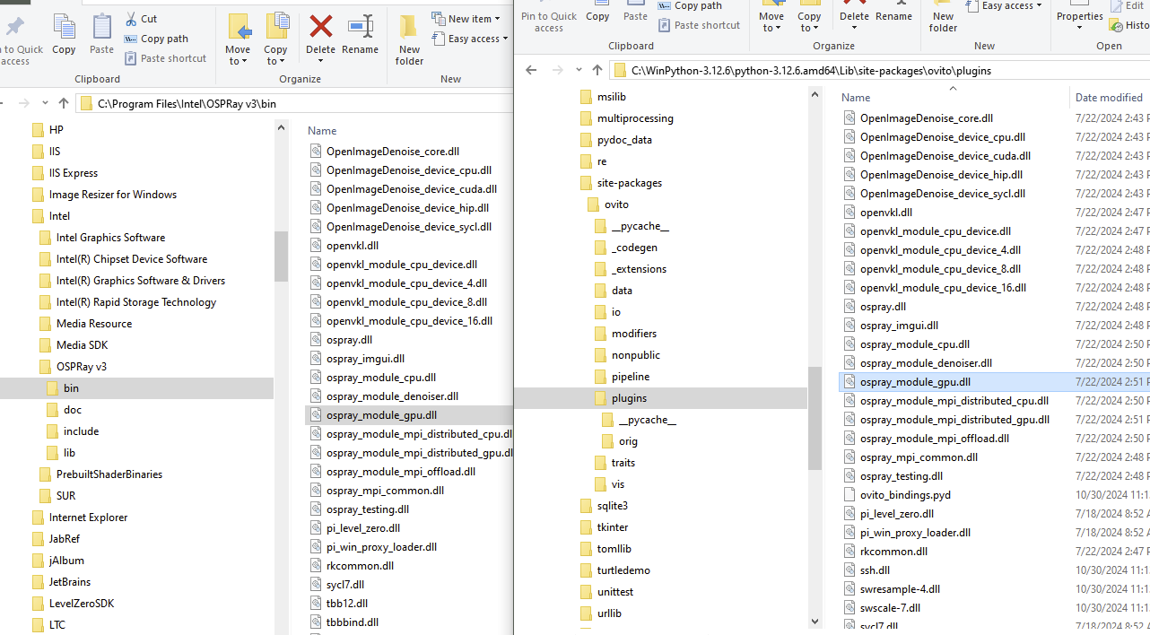

Now I tried to “force” the OSPRayRenderer from the current Python-Ovito module into “Acceleration mode” by (after backup, of course) copying all DLLs from Intel’s OSPRay package (freely downloadable, Intel OSPRay Download) into the Ovito-python plugins folder ([…]\Python-3.12.6.amd64\Lib\site-packages\ovito\plugins):
and modifying
__init__.py to load the gpu module:
This did, as I suspected (but I tried anyway) NOT work. I missed something.

I would also have been surprised if this simple attempt had actually worked. But I would be interested to know how exactly it failed. Were you no longer able to render images after the replacing the DLLs, or only in CPU mode as before?
I see two problems: We do not use the original version of OSPRay in OVITO, but a forked version, which corresponds to OSPRay 3.2.0 and has been extended by us with functions for rendering ellipsoids and superellipsoids. However, these extensions are only implemented for the CPU device, not the Intel GPU device/SYCL.
Secondly, OVITO explicitly initializes a CPU device during the rendering process (“ospLoadModule("cpu"); ospNewDevice("cpu");"). I am not sure whether this behavior can be overridden by environment variables from outside (see here).

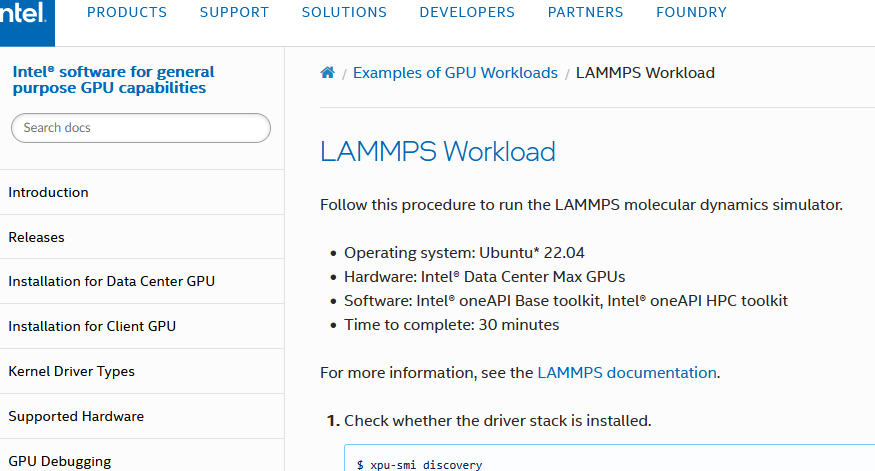

It looks like I was a bit too enthusiastic about these Intel consumer GPUs. As I found out, there are a few problems:
General “GPGPU” support including the new ARC B5xx series is provided for Linux only, at least it looks like this. They even provide build examples for LAMMPS with Ubuntu:
GPU-Hardware support for the generic OSPRay renderer appears non-existent or at least limited. Last official version is 3.2 (from 1 year ago), current version is 3.3 with almost a year of no significant updates.
Current Intel toolchain system (ONE API 2025.1) does also not specifically state support for B5xx (but mentions A7xx).
It appears that the new Intel GPU line, B5xx, has limited value for GPU computation tasks. This leads me to believe that it would be better, for now at least, to switch back to an RTX-based card. However, I would love to experiment with new ideas and concepts.
For your question regarding the Ovito OSPRay invocation: It simply took the CPU path as I could not see any difference in the images or in the processing time. The current (downloadable) OSPRay DLLs are v.3.2., and ovito-python did not complain about the files that were secretly exchanged. Maybe I didn’t call the mentioned procedures that you added.
