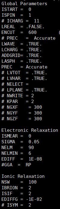

Hello all, i am trying to calculate the elastic modulus of Mg35Ca alloy (666 KPOINTS) by the strain-energy method (VASPKIT), the INCAR file is shown in the following,

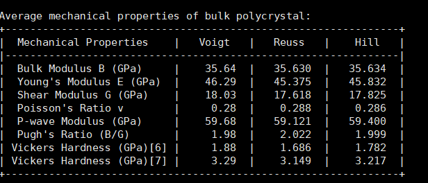

while the calculated modulus is larger than that of pure Mg,

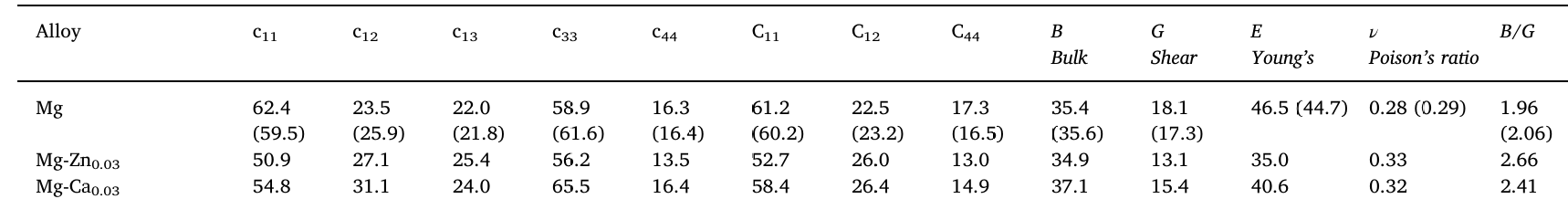

The result is different from the reference, can anyone suggest what might cause this issue or how to ensure the accurate modulus of Mg35Ca?
Thanks in advance!

While we have a workflow to compute elastic constants - the ElasticMaker in our workflow library atomate2 - you need to be cognizant of the limitations of (1) the DFT method used to calculate elastic constants; (2) the sensitivity of elastic tensor fitting to the input data; (3) matching input (INCAR, KPOINTS, POTCAR) settings with a paper that shows theoretical results
