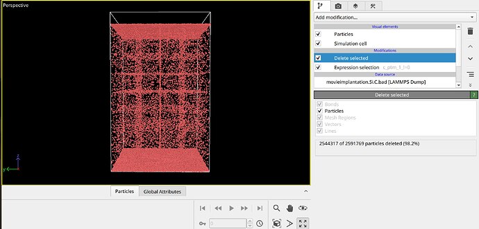

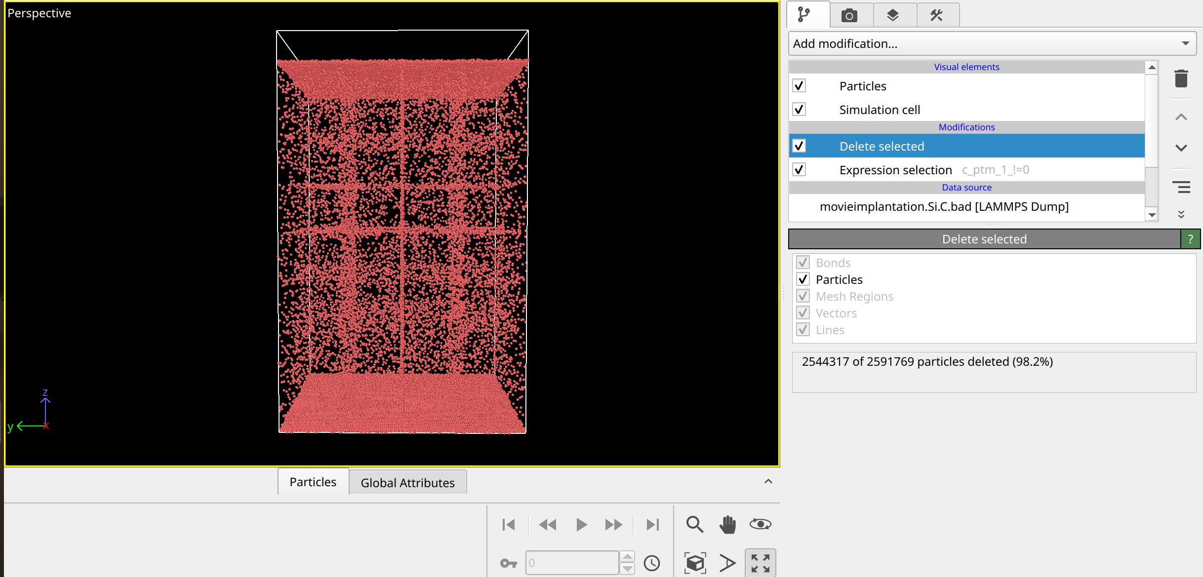

I have been trying to extract the number of defects when implanting a silicon atom into cubic diamond at 30 keV using polyhedral template matching tool in lammps. In addition, I am saving a separate file with positions of atoms that are considered defects. However, it seems that lammps incorrectly identifies the number of atoms that are not in cubic diamond structure, and editing RMSD does not seem to change anything.
Below is the script I have used, as well as the screenshot from ovito visualisation:
