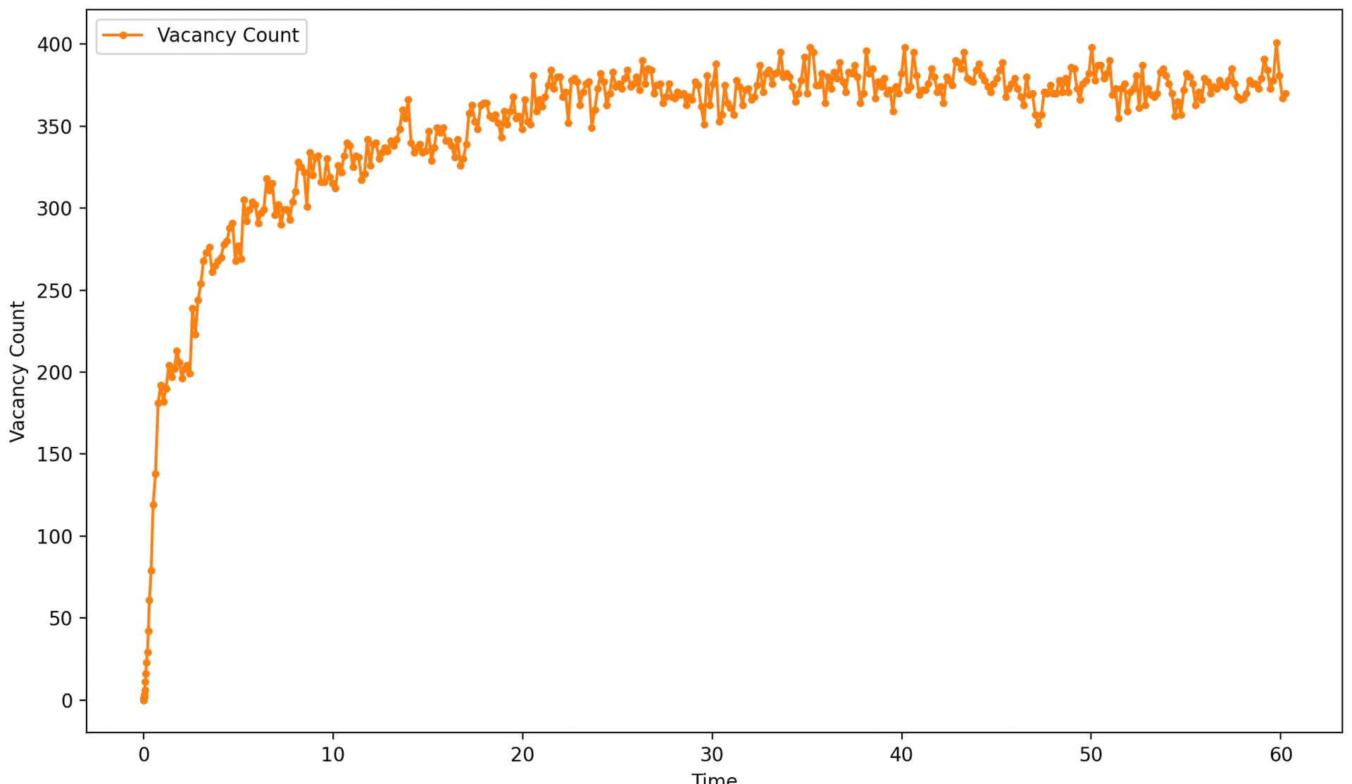

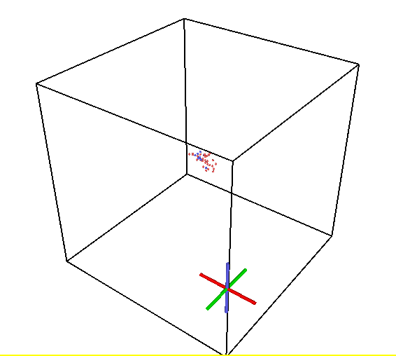

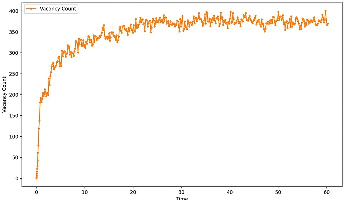

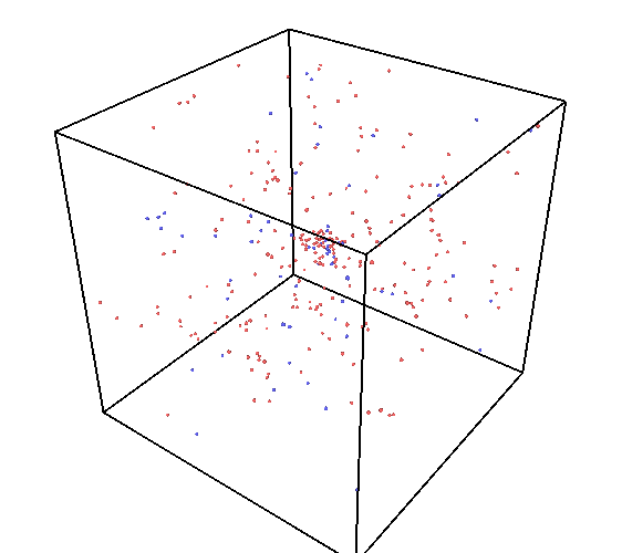

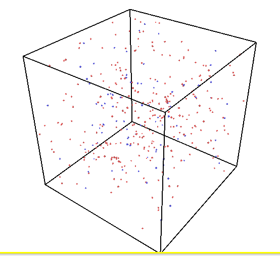

I’m investigating the cascade behaviors in U-Zr alloys at high temperatures and found unexpectedly increasing Frenkel pair numbers as attached. This behavior seems different from that reported in references for similar systems. These unexpected defects are distributed in the whole box.
I’ve tested the pure U metal at the same temperature and alloy with different phase structures at low temperatures, but such a trend is not observed in those cases.
Has anyone experienced a similar problem or have suggestions on how to address this? Thanks in advance!

Details of the analysis:
Vacancy Number vs. Time: The vacancy number is tracked using OVITO with the Wigner-Seitz defect analysis, where occupancy == 0 is used to identify vacancies.
The snapshot of the vacancy distributions at 0.25 ps, 5.9 ps, and 40 ps.
