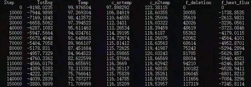

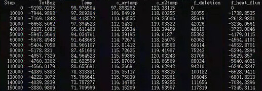

Here is what i got:
It can be seen that the nitrogen temperature (c_n2temp) is around 120 K, the temperature of the argon droplet (c_artemp) is increasing as it absorbs heat from the nitrogen surrounding it. After checking the trajectory files, I am pretty sure that the evaporation process is going as I expected.
However, the energy exchange between the nitrogen and the idealised heat reservoir (f_heat_flux) remains negative. This suggests that heat is being continuously extracted from the nitrogen group. It sounds strange to me that since the liquid droplet will be absorbing heat from the nitrogen group for evaporation, the output (f_heat_flux) should be positive, indicating that heat is being added. so, from a thermodynamic equilibrium perspective, the temperature of the nitrogen can be relatively constant.

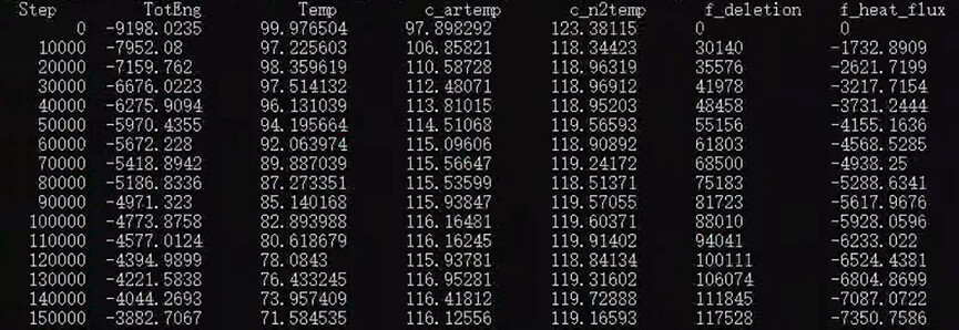

a) with fix 4 ar recenter 0 0 0 shift all units box

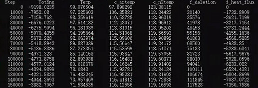

b) Turn off recenter fix

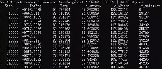

c) Turn off Langevin fix

a)with fix 4 ar recenter 0 0 0 shift all units box
b)Turn off recenter fix

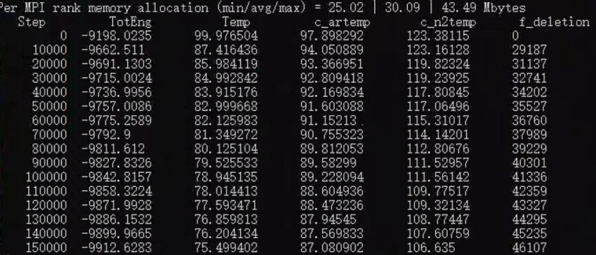

c)Turn off Langevin fix
Following is my hypothesis,
it can be seen in c), in a NVE ensemble, with the evaporation goes on, the temperature of total system is dropping with a relatively constant total energy. It is kind of meet the expectations. So, i believe relavent settings may be correct without Langevin thermostat.
However, in a) b), i would like to conclude the recenter fix have little effects on the dynamics, sorry by the way. But i noticed the sum of TotEng and f_heat_flux is relatively constant during the simulation. The total energy increased can be regard as input of Langevin thermostat. So, can i regard negative value of Langevin tally yes output as a, may be, code error?
