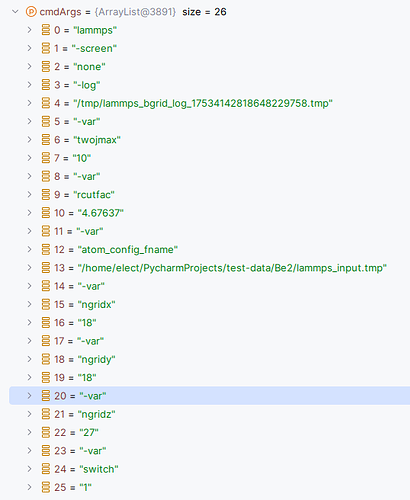

but when it’s time to lammps_extract_compute, all the fields that are 0 are fine (ie same number of them at the same indices), but the other ones are not…
If I open the logs I can spot some differences:
python triclinic box = (0 0 0) to (2.2598259 1.9570657 3.5698786) with tilt (-1.1299129 0 0)
kotlin triclinic box = (0 0 0) to (2 1 3) with tilt (-1 0 0)
These differences can only happen, if there are differences in the commands (or files) that are sent to LAMMPS, or if some index variables are set to different values (or the interface does not pass them properly). I cannot give any more specific suggestions, since I know neither Kotlin nor Mala.
Now, I do understand your point of view, but here we are talking about something very curious and particular: some fields beings cast or interpreted as integers
I tried to modify the input file on purpose to
0.0 21.2598258677677969 xlo xhi
to see if Lammps detects the difference, and it does
Reading data file …
triclinic box = (0 0 0) to (21 1 3) with tilt (-1 0 0)
So, what else can differ other than the args for lammps_open_no_mpi, the input and the compute file and bring Lammps to do that?
Ps: I’m available to modify the source code to find the issue, but I’d need some hints
