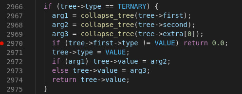

Why did lammps compute the sqrt of a negative value even if I specify the condition? With this question, I check the source code.
No matter whether arg2 and arg3 are valid, they will always be computed. In C++, the ternary opeartor has short-circuit mechanism, i.e., only one of arg2 and arg3 is calculated but not all of them.
In some cases, only one of the args is valid and computing the invalid value will yield errors. For example, only compute sqrt(x) when x>=0, only compute a/b when abs(b)>1e-15, etc.
I don’t know if it is appropriate if the source code is modified as follows:
  if (tree->type == TERNARY) {
    arg1 = collapse_tree(tree->first);
    if (tree->first->type != VALUE) return 0.0;
    tree->type = VALUE;
    if (arg1) tree->value = collapse_tree(tree->second);
    else tree->value = collapse_tree(tree->extra[0]);
    return tree->value;
