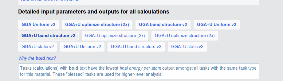

Hi @Joseph_Montoya:
Sorry to bother you again.
I am still confused about all the calculations. For example, what is the difference between the two calculations mark with red circle and green circle? I find the MAGMOM in INCAR and their initial structure are different. And the total energy of the two calculations are different, red circle is -93.935 eV, green circle is -92.944 eV. What caused this deviation?
I also calculate both structures with the pymatgen recommend vasp set. But the pymatgen recommend MAGMOM for red circle is MAGMOM = 6*5, 8*0.6, differ from shown on the website 5, 5, 5, -5, -5, -5, 0.6, 0.6, 0.6, 0.6, 0.6, 0.6, 0.6, 0.6 . So, I calculate the red circle structure in two kinds of sets. The is results shown below:
red circle:
- MAGMOM = 6*5, 8*0.6 total energy is -93.085 eV
- MAGMOM = 5, 5, 5, -5, -5, -5, 0.6, 0.6, 0.6, 0.6, 0.6, 0.6, 0.6, 0.6 total energy is -93.581 eV
green circle:
total energy is -93.047 eV
So, even if I used the same setup, I still couldn’t get the same result. Especially for the red circle, because the red circle is chosen as the lowest total energy.
Hope for your reply.
Best
Tao Zhang
The green and the red circles have different initial structures (at least sufficiently different to not be recognized as equivalent by our algorithms), but relaxed to the same structure, so are assigned to the same material. The text in your picture explains that we “bless” certain tasks (i. e. the ones that yield lower energies) and those are highlighted in bold (i. e. the red circle).
The recommended VASP input set doesn’t include considerations of magnetic orderings and occasionally materials on the website will have multiple magnetic orderings that have been tested to determine which one is the ground state. The materials details page specifies that the ground state magnetic ordering is ferrimagnetic (not ferromagnetic or antiferromagnetic, which I believe the spin states you’ve indicated in your post correspond to), and the final structure that the MPRester delivers shows that the final magnetic moments are:
[3.921, 4.009, 3.924, 4.242, -4.195, -4.195, 0.035, 0.055, 0.01, 0.055, 0.037, 0.01, 0.035, 0.037]
Which probably means we started with 5, 5, 5, 5, -5, -5, 0.6, 0.6… etc.

Hi @henkekao,
I believe the INCAR here is correct, it looks like the initial phase is AFM, but one of the -5 spins flips over the course of the VASP optimization procedure to produce the ferrimagnetic phase. Is that what you’re seeing in your calculation?
The VASP input set will give a general (i. e. FM) INCAR if the magmoms are not set in the input structure site properties. If those are set (as they are if you get the “final” structure from the MPRester), then the VASP input should reflect the structure magmoms.
