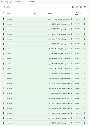

I am trying to upload my VASP calculations to NOMAD. Most of them were done successfully, while several files encountered parsing errors as follows:

Some other calculations used a similar setting have been parsed correctly. In addition, these calculations were completed, and I could find the result analysis in their Entry DATA, even though the Entry failed.
Could you please help me fix this error or give me any suggestions? Let me know if you need my vasprun.xml file.

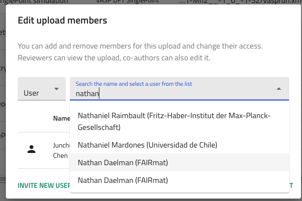

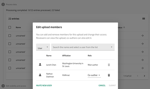

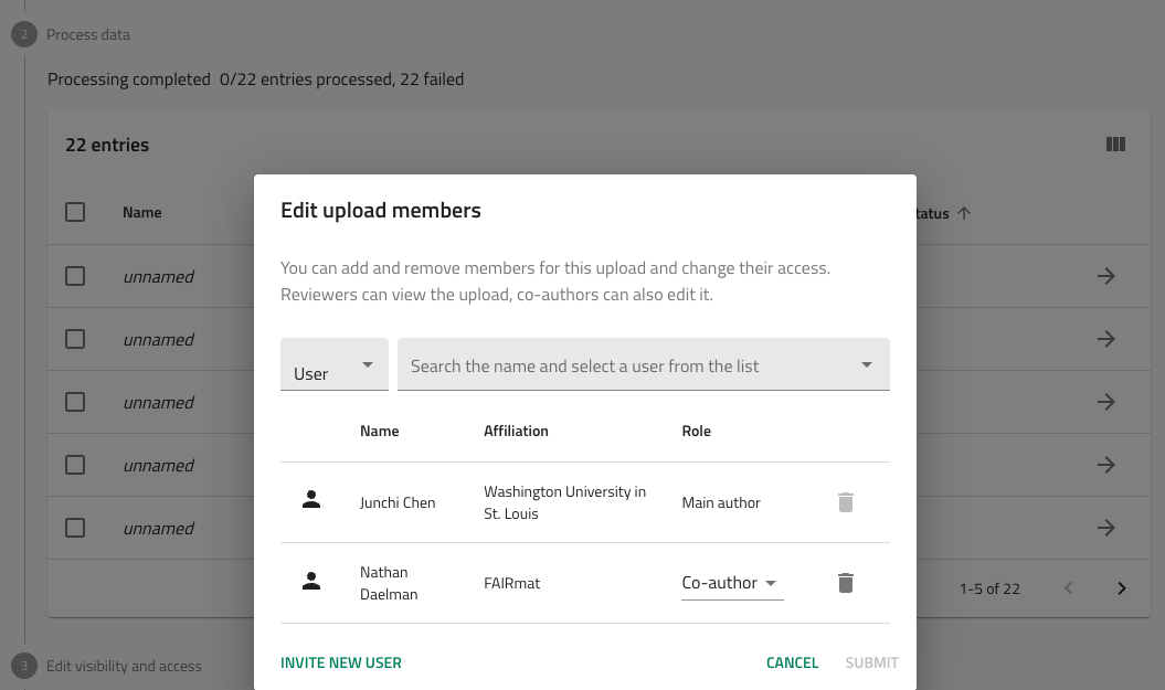

I can add you to this upload if you think that will be more convenient for testing (Let me know which one I should click). Or I can just send those failed examples to you by email as well.

@Jiongci either user is fine, I have access to both accounts. Will take a look then and report back.
Great, thanks! I have invited you to a dataset that only contains 22 failed examples. Let me know if you need anything else from me.

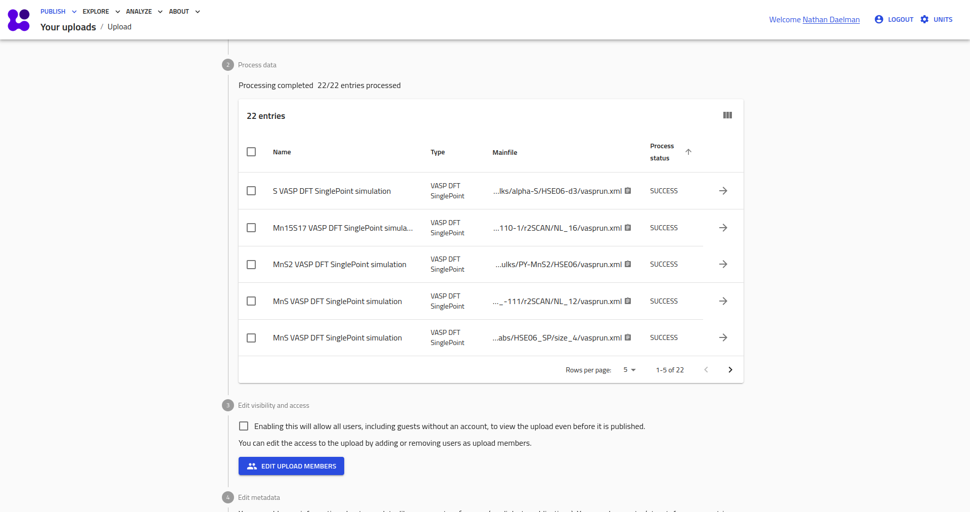

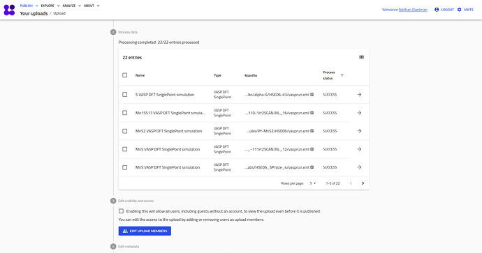

Dear @Jiongci , could you try uploading to the develop server, which has the nightly build? I tried that one myself and it seems to be passing fine (see screenshot below). Publishing there gives your entries global visibility, what test doesn’t really do. My apologies for the inconvenience.
On the upside, the fix you found exactly matches the patch I implemented. It really just came down to a delay in roll-out on test. Also my thanks to @ahmedilyas for his insight on the exact deployments!
