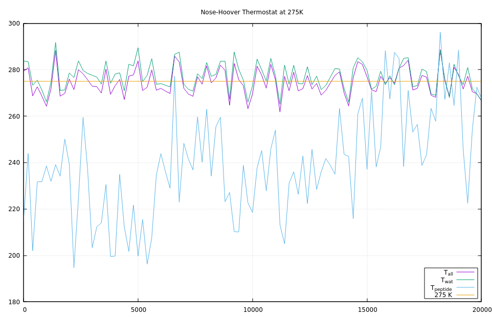

Please see the graphs below for a demonstration. I have modified the “peptide” example from the LAMMPS source distribution, so that fix shake is only applied to the water molecules and then defined separate computes for temperature of all atoms, only the water atoms, and only the peptide atoms. The timestep was reduced to 0.5fs and the length of the run extended to 200000 steps.
Due to no longer having shake constraints on the hydrogen atom bonds in the peptide, the peptide atoms are not in equilibrium at the beginning and equipartitioning of the kinetic energy is not given.
As you can see from the right graph, the peptide atom temperature is lower than the target, but over the course of the simulation they slowly pick up the kinetic energy from surrounding water molecules. Since there are so many more water atoms than peptide atoms, the water temperature is only a little bit affected and fix nvt keeps the total temperature on target, but does nothing to assist the exchange of kinetic energy of the two subsystems.

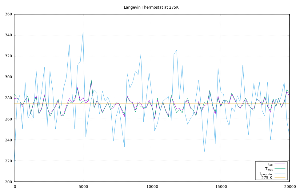

I’ve then replaced fix nvt with fix nve and fix langevin with the same relaxation time as used in fix nvt. And you can see from the middle graph that the dissipative nature of fix langevin achieves equipartitioning of the temperature between the two subsystems within the first 1000 time steps.

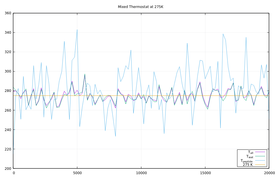

The third graph is a mix where the first 100000 timesteps use Langevin for thermostatting and then second 100000 steps fix nvt. It is quite obvious that running fix nvt will inherit the equipartition of temperatures and not break it again.

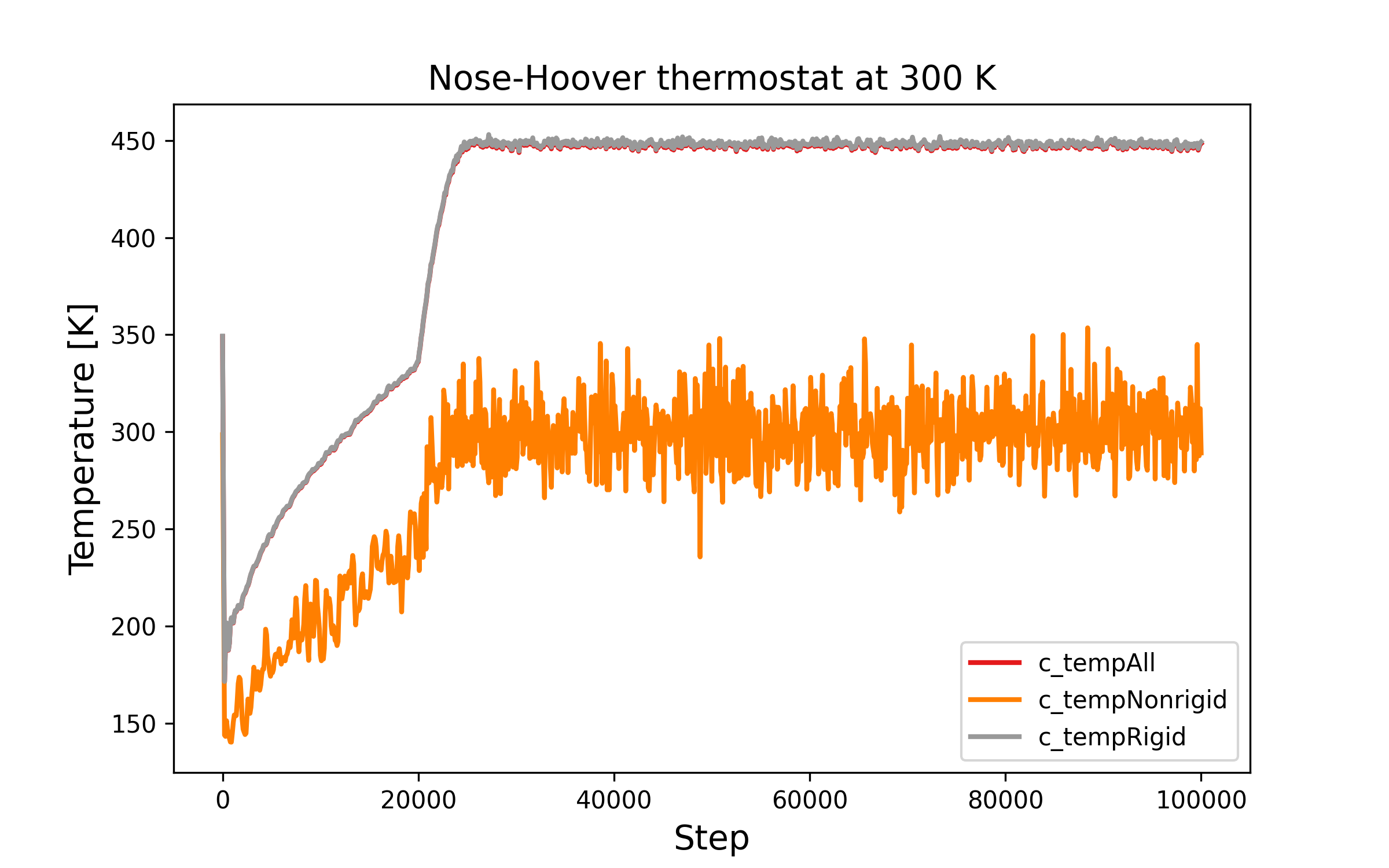

Yes I am using nvt idea, fix nvt for the nonrigid atoms and a separated rigid/nvt for the rigid bodies (water). The timestep for the equilibration in my system is 0.5 fs and total 20000 steps, and then increases to 5fs timestep and run another 80000 steps.
After I set the initial temperature at 300 K, both temperatures for the non-rigid and rigid drop, and then increase again. This is quite strange and is it something due to the “fix shake”?

This is contradicting your original post where you wrote that you were keeping molecules rigid with fix shake. It is completely pointless to apply fix shake to atoms that are time integrated with fix rigid/nvt or vice versa. For molecules kept rigid with fix shake, you use a single fix nvt for the whole system, since with fix shake you do regular atomic position updates, that are then corrected by fix shake to fulfill the defined constraint.
5fs timestep is far too large for the system you describe. If you have water molecules (or any bonds to hydrogen atoms) kept rigid with fix shake, you may get a way with 2fs, but with fix rigid on water, you are likely stuck with 0.5fs or even less to have a proper stable and energy conserving time integration.
Not at all, what happens after the initial velocity assignment depends on how high the potential energy was of the system before. If it had been subject to a thorough minimization, it may be in a state representing a 0K configuration. In that case the temperature will drop to about half.
But what can happen in your case, if I understand your description correctly, could be that you are removing the rigid constraints twice for no good reason and that would be consistent with a temperature of about 450K for a 300K thermostat.
