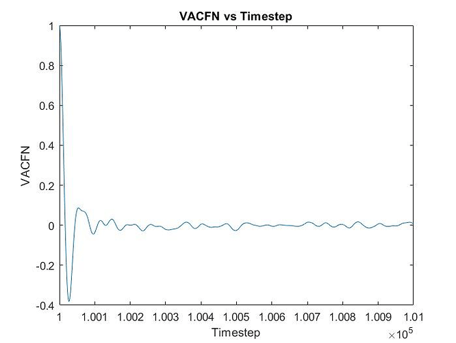

Hello.
I wanted to calculate VACF for the SPC/E water model where in the input scripts of LAMMPS (attached below), I read the data of the coordinates of all the atoms (9576 atoms total for 3192 molecules) from the GW.dat file and got the values of VACF using “compute” command. However, I got a similar trend of VACF but did not get the accurate curve. I have just started to learn MD and am still a novice, so can anyone tell me how to improve my result even more by looking at the script or give any advise regarding that? Thank you.
