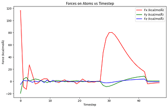

and then I computed the force between the two atoms
and
I can see that when I use fix bond/break the forces are not that big. But the authors of the paper suggest temperature rescaling during the simulation. Is there a way that this can be done under NPT?
