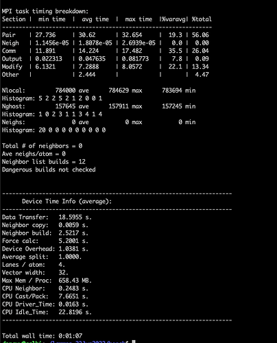

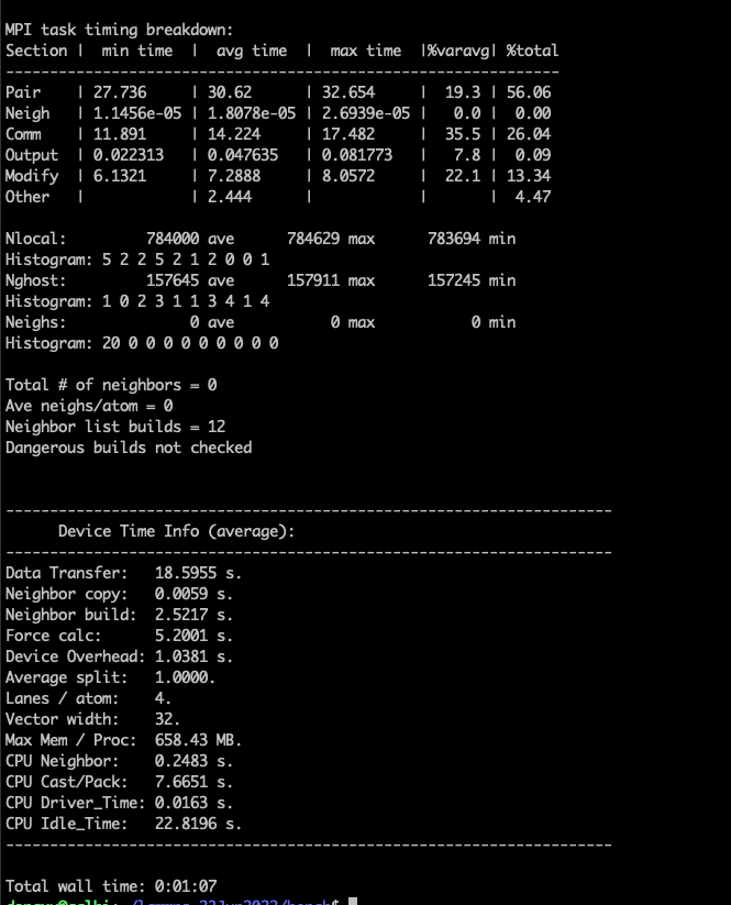

Thanks for the reply.
" https://docs.lammps.org/Run_output.html "
If I use the GPU package, will this computation(Pair) happen on GPU?
I am curious about the workflow of GPU packages.
In the output, they give two breakdown time.
Here, we got MPI time and device info.
Does MPI time include the device time?
The command is
mpiexec -np 20 …/build/lmp -sf gpu -pk gpu 1 neigh yes newton off -in in.example1
Thanks in advance.
