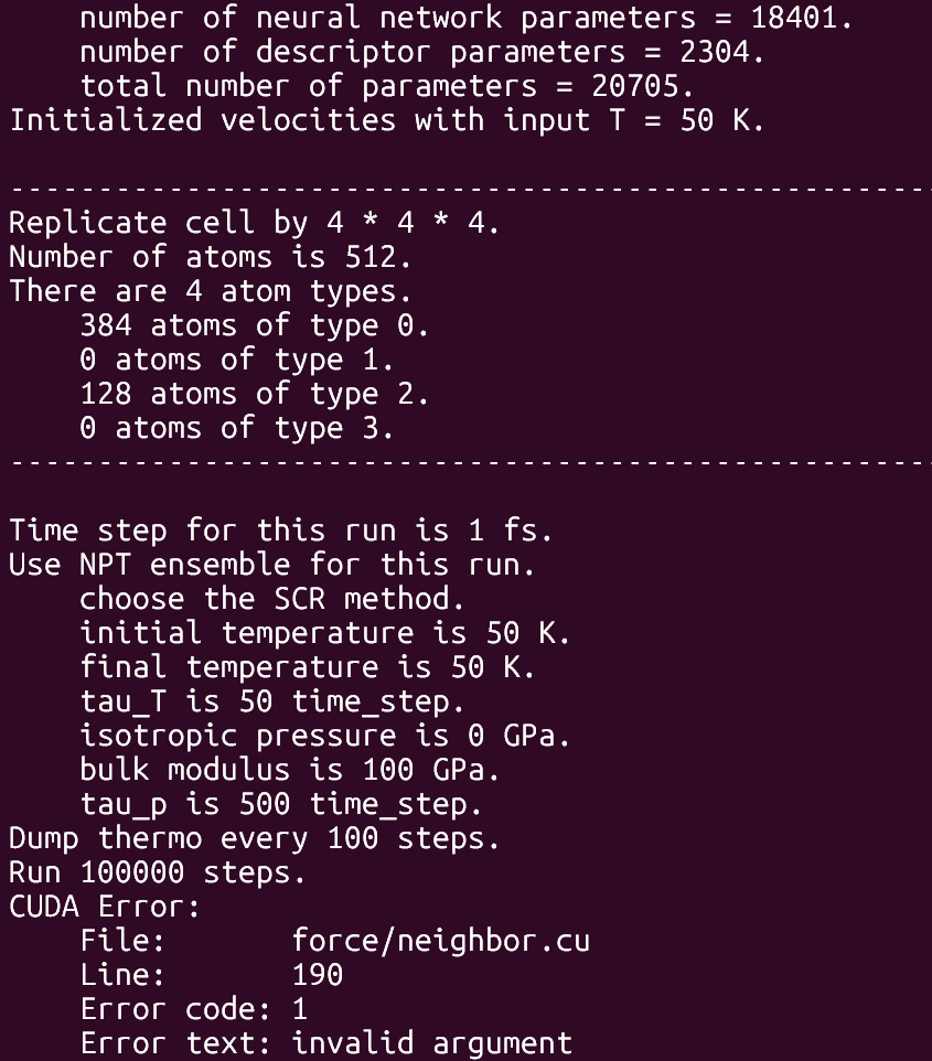

When using the keyword "replicate" in GPUMD for supercell expansion, an error occurred: force/neighbor.cu, invalid argument.
When using the keyword “replicate” in GPUMD for supercell expansion, an error occurred:

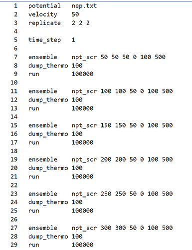

The error was caused by the subtlety of the replicate keyword, which must be put before the potential keyword (check the documentation here: replicate — GPUMD documentation).
