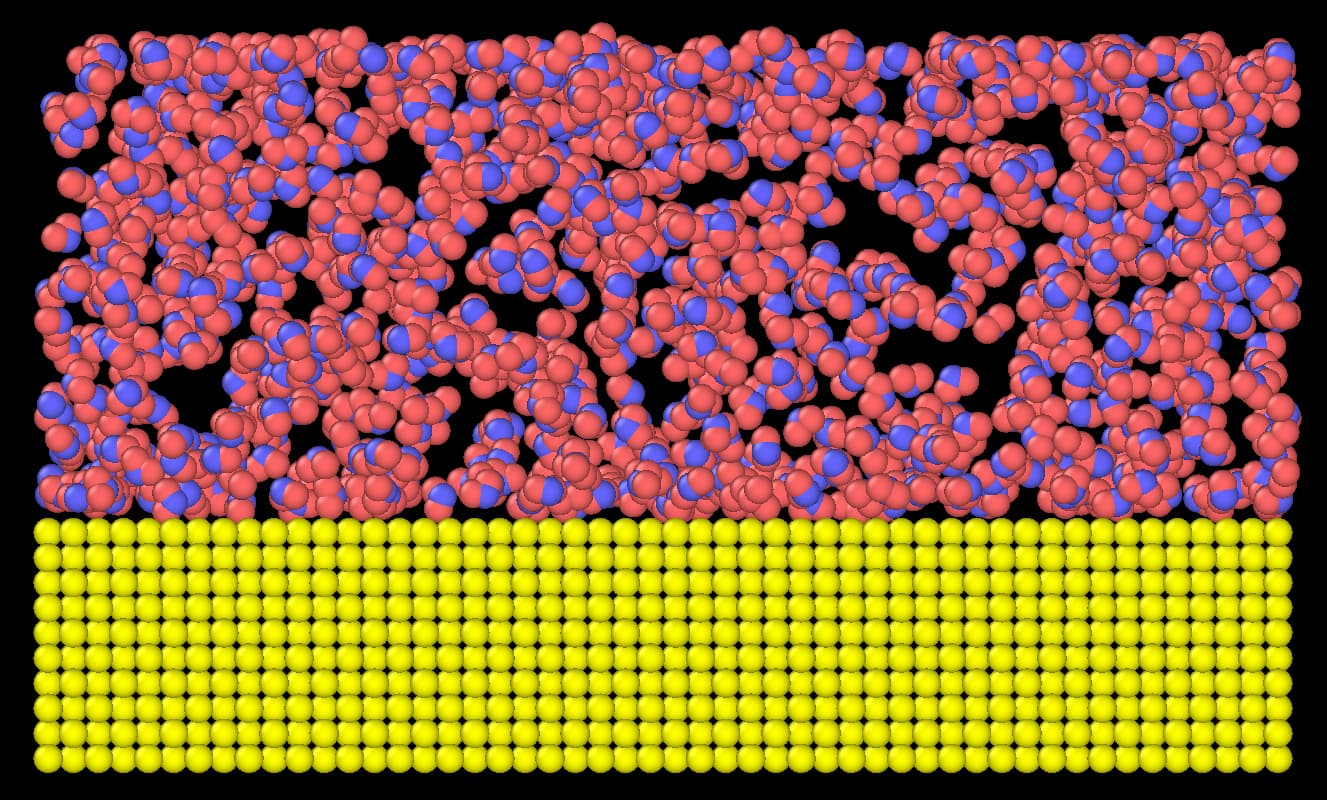

I build a water-silver interface system. 1000 H2O molecules sit above 12500Ag atoms. The initial structure looks like,

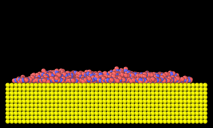

I assumed the reustls should be same since all silver atoms are not moving so that water should move the exacly same way. However, it’s not. After 200ps, the result of fix all nvt is like,
And I cant understand why water is almost evenly distributed vertically.

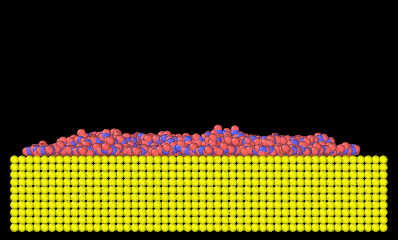

However, if it is run by fix water nvt, it is like,
Now silver is nearly hydrophilic.
What I dont understand is that why there is such a difference in water behavior when applying thermostat to all atoms or only water atoms in the situation that silver atoms are immobile by setfore 0 0 0. The interatomic force should be exactly the same but it is not.
