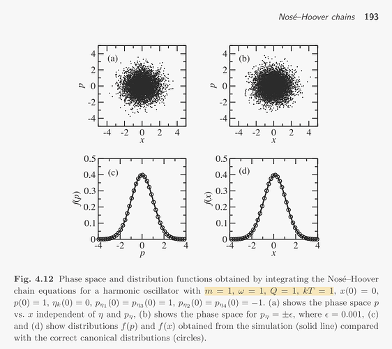

I tried to reproduce the harmonic oscillator described in Tuckerman’s book by adding a chain as instructed, but I still got standard error results and bimodal distribution.

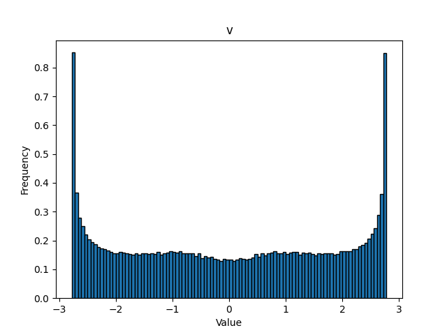

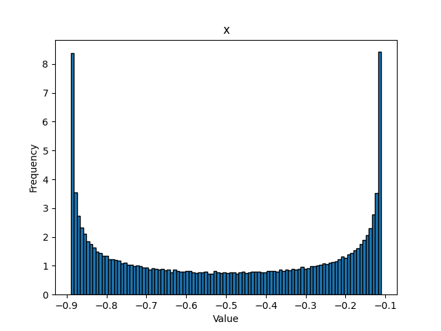

Thank you very much! I am new to LAMMPS. However, I just ran this code and found that the distribution is still not the correct canonical distribution. What could be the problem?

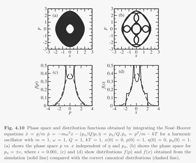

I sincerely appreciate your assistance! I am truly grateful for your guidance on the matter of LAMMPS subtracting 3 degrees of freedom by default, which has also resolved my confusion regarding the absence of temperature for individual particles. I am attempting to verify a harmonic oscillator using Nosé-Hoover method is just like microcanonical ensemble, while coupled to a Nosé-Hoover chain thermostat will be canonical ensemble.
