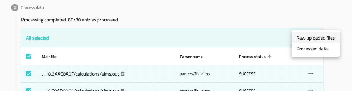

Ok another thing (unrelated): When I donwload raw data I get a file raw without file ending or anything. Then I have to guess it’s a zip file to be able to unpack it.

I am clicking through our various download options. Downloading multiple files from the raw files tab of an individual entry only shows the entryid and not .zip. Here it would be better that raw.zip. We can change that.
The other downloads (download button on top of upload page, download entries from the processing step of the upload page, download button in the overall search), seem all to suggest raw.zip as download file name. Maybe it is my browser making assumptions based on the content type header.
If you use the API, we are a bit limited. Not really sure how curl would create a file name.
The raw problem seems to be happening in Firefox, not Chrome. We switched to a proper library to implement the downloads in an upcomming release (don’t worry the URLs wont change;-). This will fix this problem.
