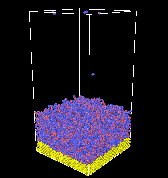

The system is composed of Cu and water interface as shown in the figure.
When the water is evaporated in the bulk, it floats to the top of the box. when a molecule is in the evap_space, it will be deleted. Through the fix evaporate command, I did observe a decrease in the number of atoms, but correspondingly, the energy of the system should decrease as the number of atoms decreases, but the simulation results are not like this.the atom-steps is shown in the figure.

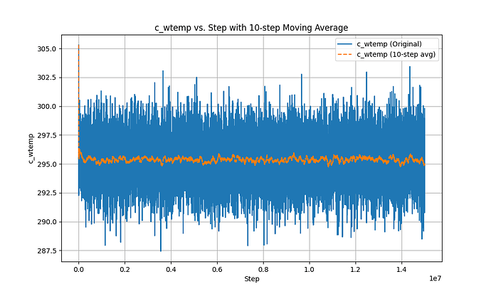

the tempreature plot is shown in this figure.
