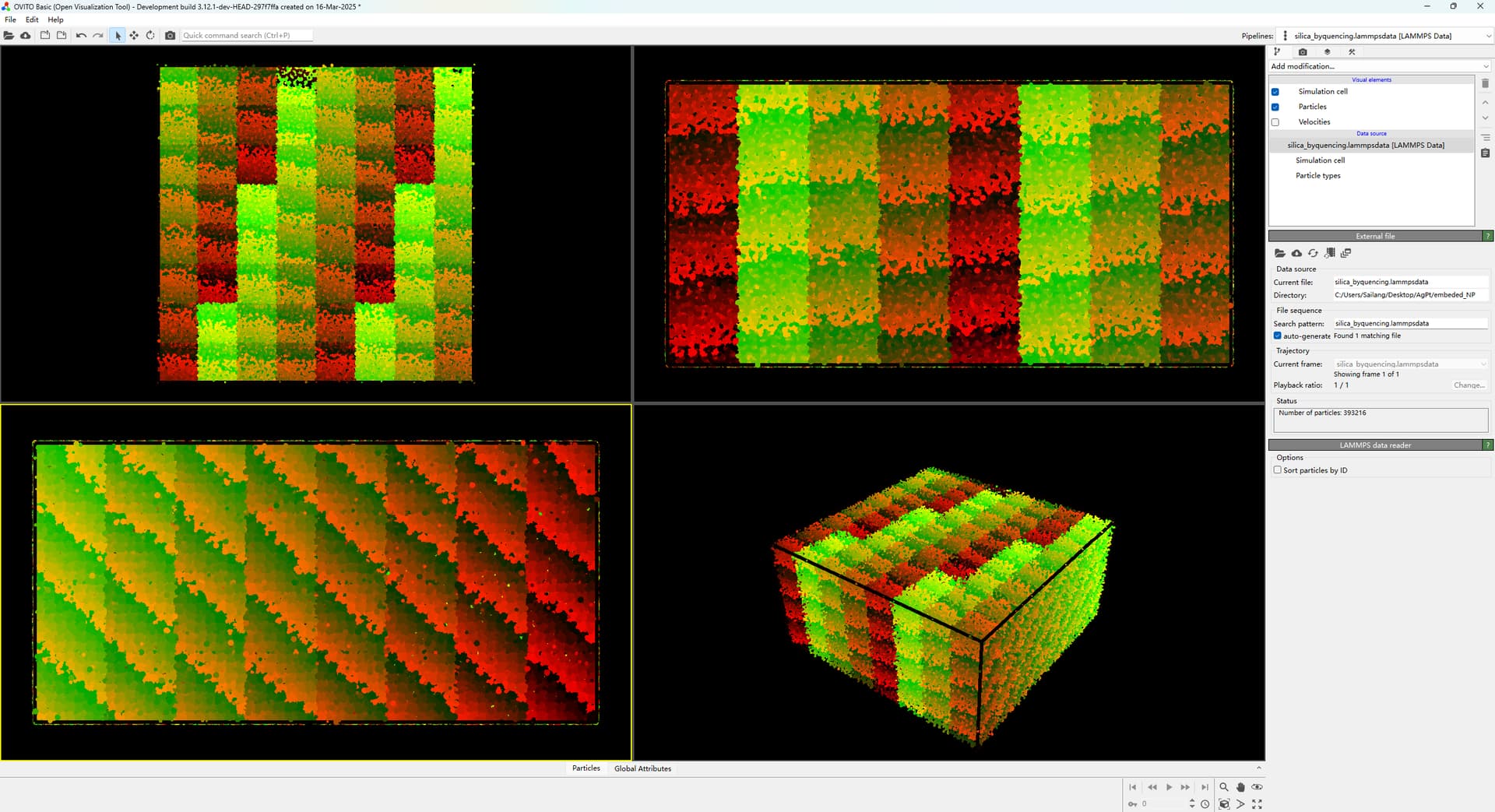

Thank you very much for your effort. In my case, the bug persists in the new 12.1 dev version. I am very sorry for that.
A snapshot is attached.

Thank you, Fan, for testing this version. Yes, it is a pity that this has not yet led to any improvement, but we will continue to look into other possible fixes. It would be helpful if you could continue to assist us. Daniel and I will probably ask you again to test a new version sometime.

In this new version, OVITO uses a separate OpenGL context to perform the object picking offscreen rendering pass. That’s the (red & green) false-color image you accidentally see on screen, which is supposed to be invisible. Let’s see if this code change brings any improvement. Thanks.
