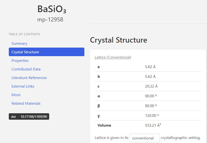

When I used the following code to download the data mp-12958, an error occurred. The lattice parameters of the downloaded data were inconsistent with those on the website.
Hey @Chuanxi-cairen, take a look at this question - the short answer is the API is returning the primitive cell, the website is showing the lattice parameters of the conventional cell
