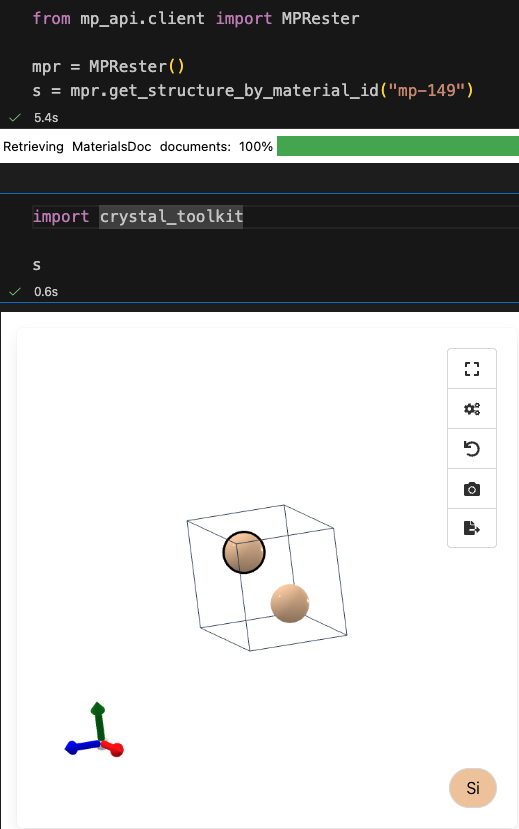

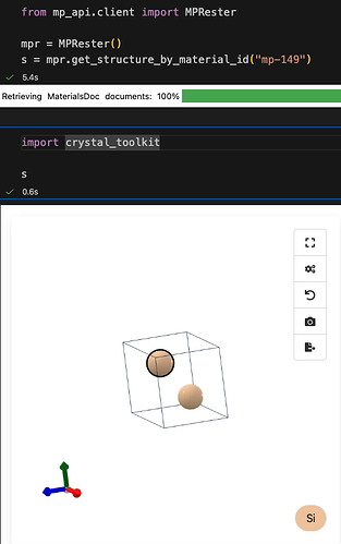

With `pymatgen==2025.5.2` and `crystal_toolkit==2025.7.31`, I'm having no issues rending structures. You may just need to update your dependencies.
