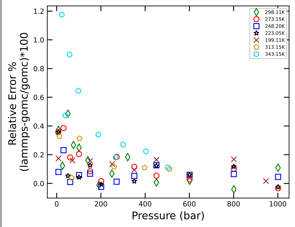

One other important point is that this density difference is pronounced and very systemic for one particular temperature and pressure. I have explored many other temperature / pressure regimes and I am including the graph for further elaboration.
Well, clearly the central C-C bond vibrations are to blame. This is backed up by the trend that the discrepancy increases with higher temperature and lower pressure: at lower pressures intramolecular forces dominate intermolecular forces, and at higher temperatures vibrational modes have more energy.

If you look at the systemic increasing trend at high temp (as pressure is decreased) which again points out something systemic and not statistical scatter.

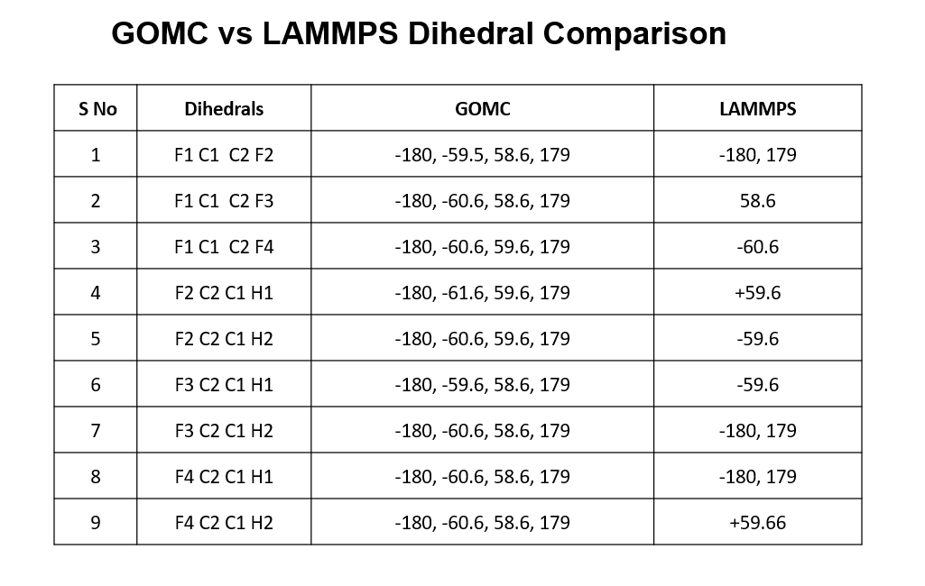

Since you have already mentioned something’s going on with intramolecular forces, my mind is kind of stuck on dihedrals. I used vmd tcl scripting (.dcd) to see what dihedrals are exactly being sampled in both GOMC and LAMMPS. There are 02 types of dihedrals and total 9 dihedrals. I found out that in GOMC, all 9 dihedrals sample correctly (±60, ±180) but lammps behavior is strange. My results are enclosed in the image below. I am wondering if this could be the reason of this behavior. And if so, how to get LAMMPS sample all proper dihedrals.

Regarding the dihedrals, the most likely explanation is that Monte Carlo, if the steps are big enough, can “jump” barriers in a way that molecular dynamics can’t, since an MC step is accepted just based on the energy difference between initial and final state while in MD a transition must get over the activation barrier.
