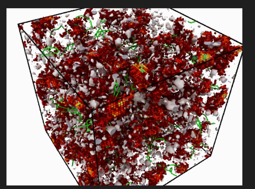

I’d like to remove the Defect Mesh from Python. In the GUI I can unselect ‘Defect’ after having loaded the DislocationModifier then render my animation
This link makes no reference to defect_mesh so I’m not too sure how to access the defect mesh visual in order to disable it
You already posted the correct manual entry. The defect_vis property of the DXA modifier gives you access to the SurfaceMeshVis element controlling the visual representation of the generated defect mesh. Moreover, the visibility of a so-called visual element, in general, can be controlled through its enabled property, as explained here: ovito.vis — OVITO Python Reference 3.10.6 documentation.
